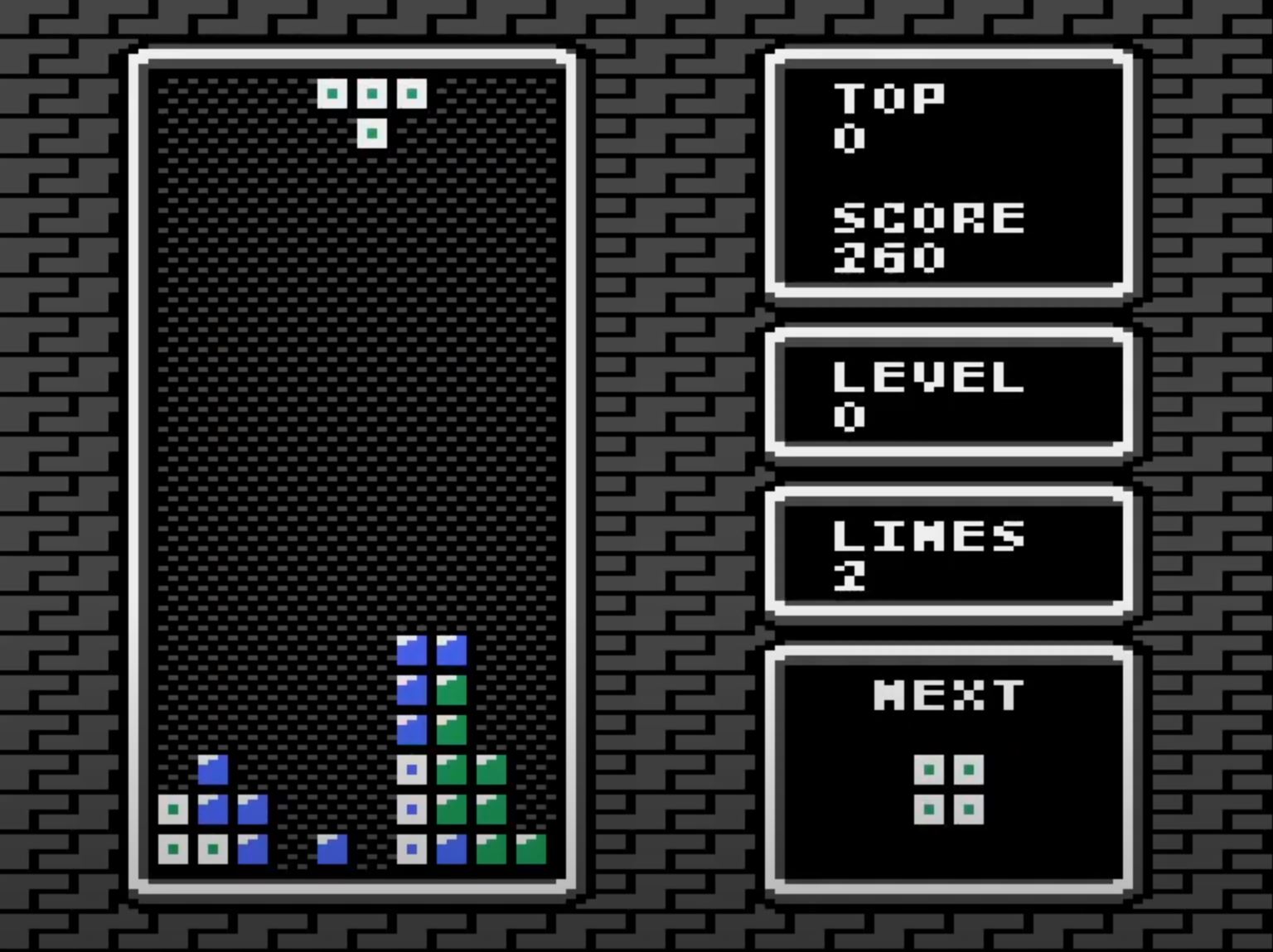

Atari 8-Bit- TETRIS - 2024 neues Game für den BASIC 10 Liners Contest von Eric C

Hier der Beweise, dass es BASIC ist. Leistungsfähige 8-Bit-Hardware (Atari natürlich); neu entwickeltes BASIC, das geradezu zugeschnitten für den Wettbewerb ist; talentierte Programmierer (Eric Carr, Victor Parada) -> die programmieren alle in Grund und Boden im Wettbewerb, nahezu unfair 😀
https://img.itch.zone/aW1hZ2UvMjU4MjA5MC8xNTM3MTMwNi5wbmc=/original/O%2BhzbZ.png
Verständlicher wird's natürlich, wenn man es aufdröselt...

  _playMusic=not _playMusic
  if _playMusic
    if _noteBeat
      ' This executes between the notes
      dec _noteBeat
      ' Fade base note volume
      poke _sound-1,$a1+_noteBeat
    else
      ' Play new note
      inc _musicI
      ' Play the bass note (dpoke to set both the note byte and the volume byte)
      dpoke _sound-2,_music(_musicI+112)+$A200
      ' Play the lead note, or decrease volume if 0 (fade away)
      IF _music(_musicI):poke _sound,_music(_musicI):_vol=3: elif _vol: dec _vol: endif
      poke _sound+1,$a0+_vol
      if not _musicI&15
        _pattern = _pattern mod 24 + 1
        _musicI = _data(_pattern+113)*16
      endif ' Pattern mode
      ' There are 4 beats between each note
      _noteBeat=4
    endif
  endif
  ' Pause the frame
  pause
endp.

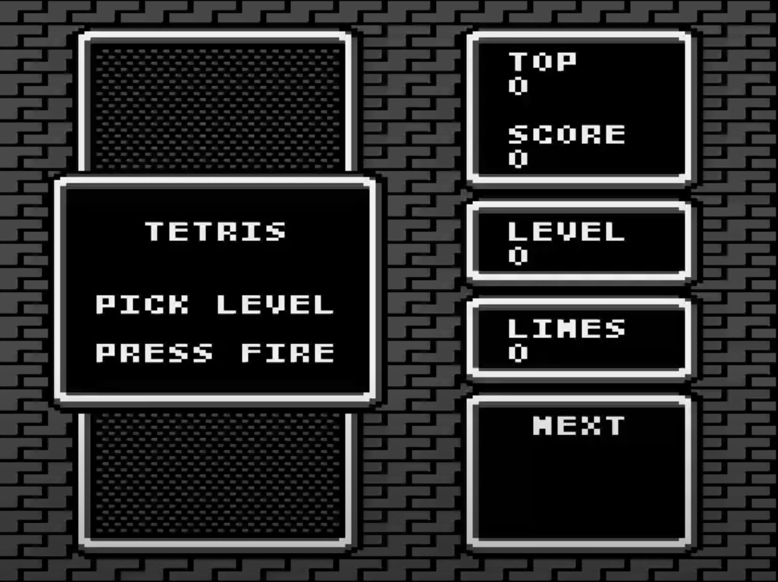

' ===== Outer loop - starts a new game
do
' Prompt Title and wait for key press to continue
' Draw title box
_brush=0:k=13:@O 226,10
' Print labels:TETRIS,PICK LEVEL,PRESS FIRE; POKE 709,4 to reset background color
'@C 1+&""$08$25$71$01$34$25$34$32$29$33$81$0A$84$71$30$29$23$2B$00$2C$25$36$25$2C$0A$C4$71$30$32$25$33$33$00$26$29$32$25$01$C5$02$04$00
@C 1+&""$06$26$71$34$25$34$32$29$33$0A$84$71$30$29$23$2B$00$2C$25$36$25$2C$0A$C4$71$30$32$25$33$33$00$26$29$32$25$01$C5$02$04$00
' Wait a bit before allowing input
pause 30
' Update high score if the new score is the best
if _score%>_topScore%then _topScore% =_score%
' Proc - Starting at memory address h, loop through multiple entries of [length][dest address][data...]
' and copies data to destination address. Loops until it reads a [length] of 0, signifying end of entries.
' This allows me to copy text to the screen, set data in memory, etc. in less code than using POS./?/POKE
PR.C h
  while peek h
    move h+3,dpeek(h+1),peek h
    h=h+peek h + 3
  wend
ENDP.
' Reset level, lines, etc variables to 0
mset &_level,14,0
' Wait until joystick trigger is pressed to start game
while peek 644
  ' Get current joystick state (1 for up or 9 (same as -1 when mod 10 is applied) when down). s.0 is shorthand for stick(0)
  k=(not s.0&1) + 9*not s.0&2
  ' Detect if up/down is newly pressed, and play sound, change level, update value on screen
  if k-h and k
    @s 55,5
    _level=(_level+k) mod 10
    @V
    pause:sound
  endif
  ' Track current joystick state to know when it is newly pressed
  h=k
wend
' Begin new game
@g
' New piece
@N
' TEMP TEST - draw a bunch of pieces for an easy tetris
'for i=0 to 3:mset _scr+580+32*i,9,9:next:_nextPiece=4
' ============ Main gameplay loop ============
do
  ' Pause game on key press - covers tetris playfield to stop cheating ;)
  ' K. is a shortcut for KEY()
  if K.
    SOUND ' Clear sound
    ' Backup the screen
    -move _scr,_scr+768,768
    ' Fill in the tetris playfield with the current brush
    k=11:@O 35,22
    ' Consume the pressed key (do this after blanking, since CAPS LOCK triggers a key waiting but does not get K)
    GET K
    ' Wait for another key press
    GET K
    ' Restore the screen
    move _scr+768,_scr,768
  endif
  ' Count down until the next frame where the piece auto drops
  dec _dropCounter
  ' Track current piece rotation and position in case we need to restore to it after attempting an invalid move
  _rotIndexBak=_rotIndex
  _tetPosBak=_tetPos
  ' Clear intermittent gameplay sounds (moving/rotating piece)
  sound 0
  ' Read Joystick
  k=stick 0
  ' If joystick is not "down", clear "can drop" flag, allowing the player to soft drop when
  ' they next press down
  if k&2
    _canDrop=1
    _dropScore=0
  ' Start soft drop if "down" is pressed
  elif _canDrop
    _dropCounter=0
    inc _dropScore
  endif
  ' Check if joystick is pressed left or right
  k=(n.k&8)-n.k&4
  ' Set h to 0. This will be set to indicate a move/sound has occurred
  h=0
  ' If joystick was pressed in a direction, check if we should move
  if k
    ' Keep track of frames joystick held in a direction. If held long enough, repeat move.
    dec _framesHeld
    if _framesHeld<0 or k-_dirBak
      ' Flag we will move and set beep frequency with one statement
      h=35
      ' Set new position
      _tetPos=_tetPos+k
      ' Wait a few frames before continuing to repeat move
      _framesHeld=_framesHeld+3
    endif
  else
    _framesHeld=9
  endif
  ' Store direction to allow only once left/right movement per joystick push, except when holding for some time (handled by _framesHeld)
  _dirBak=k
  ' Read joystick button
  k = not peek 644
  if k>_rotBak
    ' Flag we will rotate and set beep frequency with one statement
    h=55
    ' Set new rotation index, using a formula to determine max rotation positions (1,2, or 4) based on tetIndex
    ' The formula was less code than storing the rotation max per type
    ' Using & since it is less chars than MOD (e.g. &1 instead of MOD 2, &2 instead of MOD 2)
    _rotIndex = _rotIndex&((_tetIndex+1)/3+_tetIndex/5) + 1
  endif
  ' Store rotBak to only rotate once per joystick button press
  _rotBak=k
  ' Do one of three options
  if h ' 1) Draw moved/rotated piece
    @L
  elif _dropCounter>0 ' 2) Wait if still counting down to drop
    @W
  else ' 3) Drop
    _dropCounter = _dropCounterStart
    ' Test/Move to new location
    _tetPos=_tetPos+32
    @L
    @W
    ' New position not valid - lock piece into place
    if not i
      ' Proc - Check if new Location is valid for a tetromino to move/rotate to.
        ' If valid, it plays a sound and draws the piece in its new location
        ' If invalid, it sets i=0 so the caller knows movement failed
        PR.L
          @I
          FOR j=0 to 3
            if peek(_tetPos+_data(i+j))&8
              i=0
              _tetPos=_tetPosBak
              _rotIndex=_rotIndexBak
            endif
          n.
          ' Play rotate/movement sound if piece moved left/right or rotated
          if i*h then @s h,5
          ' Wait a frame
          @W
          ' If the new location is valid, move to that location
          if i
            ' Clear old position
            for i=_oldCalcPos to _oldCalcPos+3
              h=_tetPosBak+_data(i)
              if h>$7043 then poke h,3
            next
            ' Draw piece in new position
            @D
          endif
        ENDP.
      ' Draw using locked chars
      _brush=_brush+7
      @D
      ' Check for filled rows to clear
      ' Starts at the first square (always top most of a tetromino) and the 3 rows below that
      k=0
      h=(_tetPos+_data(_oldCalcPos)-_scr)/32*32+_scr+4
      ' Loop through 4 rows to check if any are completely filled in
      FOR I=0 to 3
        ' Check all ten blocks are filled. Break early if empty playfield or ui element found
        j=h:while peek j>7:inc j:wend
        ' If we got to the end without an empty space, and we are within the
        ' bounds of the playfield, we have cleared the row!
        if j>h+9 and h>$7043
          ' Increment cleared lines counter
          inc _lines
          ' Store this as a row to clear
          inc k
          _clearedRow(k)=h
          ' Check if the player moved to the next level
          if _lines mod 10=0
            ' Increase level
            inc _level
            ' Increase drop speed
            if _dropCounterStart>6 then _dropCounterStart=_dropCounterStart-2
          endif
        endif
        ' Wait a frame, then move to the next row on screen (32 chars per screen row)
        @W
        h=h+32
        ' If we reached the end of the playfield, exit early
        if h>_scr+676 then exit
      n.
      ' One or more rows was filled
      if k
        ' Score appropriate based on level and rows filled
        _score%=_score%+_data(k+109)*(_level+1)*20
        ' Animation - Visually clear out the rows from center out, with sound effect!
        for h=1 to 5
          ' Temporarily use _dropCounter to set sound pitch
          _dropCounter=70-h*10
          ' Flash screen on a full tetris (clear 4 lines)
          if k=4
            poke 709,6-h&1
            _dropCounter=23+24*h&1
          endif
          ' Play sound, wait
          @S _dropCounter,3
          @W
          ' Play sound at a lower pitch
          @S _dropCounter+50*(k<4),5
          ' Clear a section of each row
          @W
          for i=1 to k
            mset _clearedRow(i)+5-h,h+h,3
          next
          ' Wait, play sound
          @W
          @S _dropCounter,2
          @W
        next
        ' Stop attract mode in case keyboard key hasn't been pressed in awhile
        poke 77,0
        ' Clear sound effect
        s.0
        ' Shift upper rows down in place of the cleared rows - 41 chars left
        for i=1 to k
          for h=_clearedRow(i) to _scr+69 step -32
            move h-32,h,10
          next
          @W
        next
        ' Clear top row after sliding everything down, otherwise it will stay unchanged
        mset _scr+68,10,3
      endif
       ' Score soft drop
      _score% = _score% + _dropScore
      ' Update stats on screen
      @V
      ' Check if game ended (the top tetromino was locked before it could fall)
      if k=0 and _tetPos=_scr+9 then exit
      ' Get next tetromino
      @N
    endif
  endif
loop
' GAME OVER
' Clear sound
sound
' Darken the background for a bit and pause to signify game over
poke 709,3
pause 40
loop
